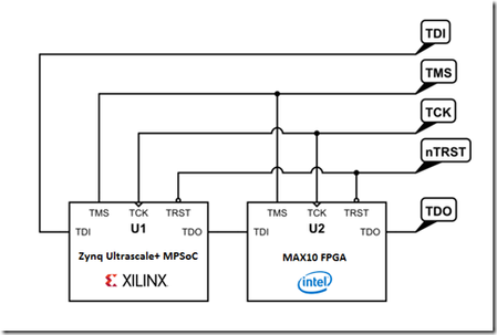

7 years agoWhat JTAG method when used MAX10 With Zynq US+ MPSOC.
Hi Is this below JTAG Chain configuration is possible ? Regards Prashanth Kumar G N

7 years agoHi Prashanth,
Yes, If they are JTAG compatible devices, it should work fine.But using USB-blaster you can program xilinx device and vice versa.We have use some other tools to program it successfully.
Refer below link.
https://forums.intel.com/s/question/0D50P00003yyGV7SAM/jtag-chain?language=en_US
