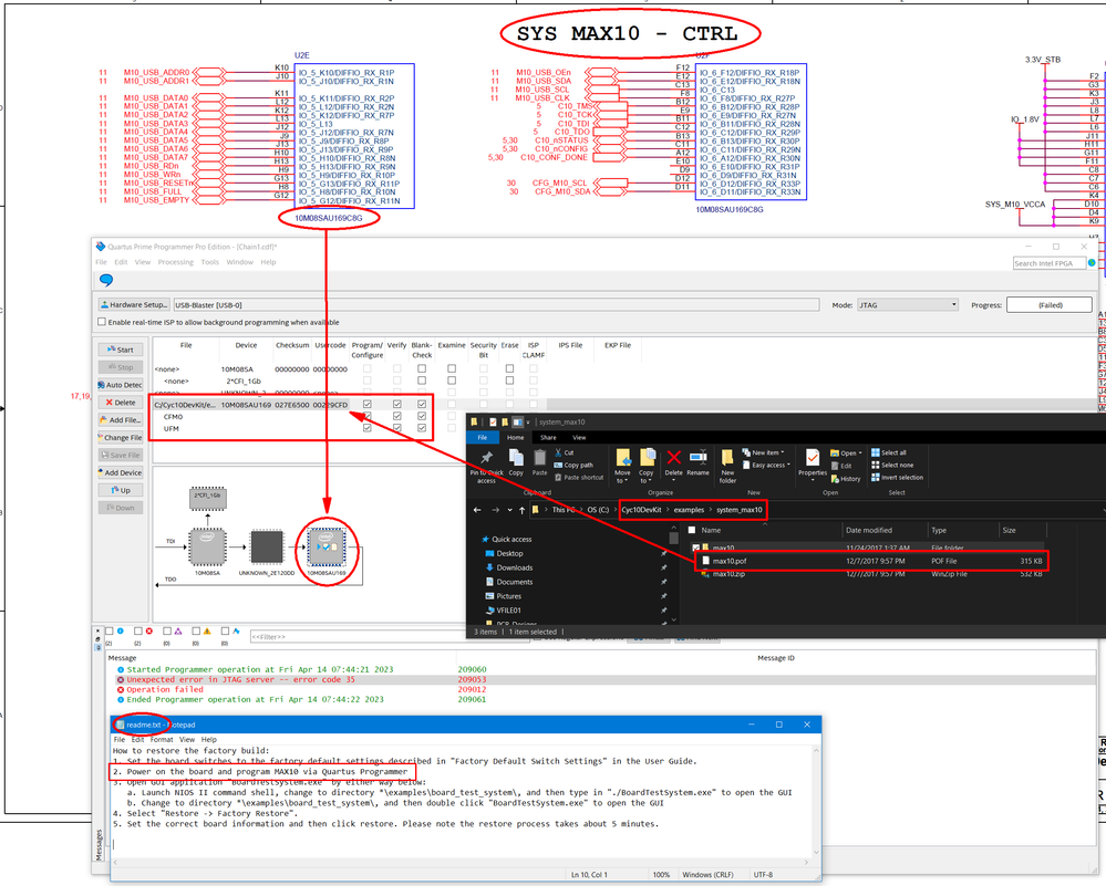

  • Finees's avatar
    Finees
    Hi
    This is the message that I get error 35

  • Finees's avatar
    Finees
    Hi WZ2
    Thank you for information, however the problem is the same.
    From everything that I am seeing, it looks like the board is configured for a development package that is based on Quartus-Ver16.1.1.200 but, the only available development package is based on 17.1.0.240.
    Now if I try reprogram the System MAX10, with dev -archive .pof, I would have the version 17 system from development package on the board and it would be compatible. So, when I try to program this MAX10with my USB-Blaster (JTAG port) I get error code 35.
    Do you have any recommendation?
