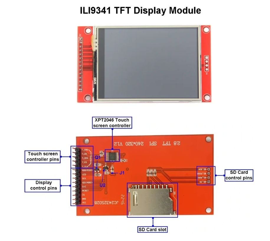

this is the lcd ili9341 screen im trying to configure with VHDL for project, ill add here in the end the modules i built. i created an SPI module and ili configuration module by looking at the data sheet and inspecting another modules online, i find it dificult to configure it with the configurations i have found, also i have tried to work with lower system clk for the SCK around 10MHZ so the system would not exeed the system clock that should be maximum 24MHZ. please someone could help me find a way to configure it and explain to me the process of showing data over the screen.
