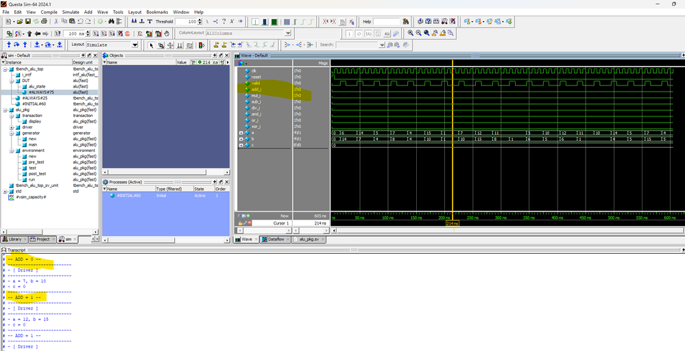

HI ,
I am trying to simulate a generic ALU in Systemverilog UVM test environment . My add_i is random input signal , but when i open my wave i dont see it toggling , but the display function reports it is being toggled ?
here are my files :

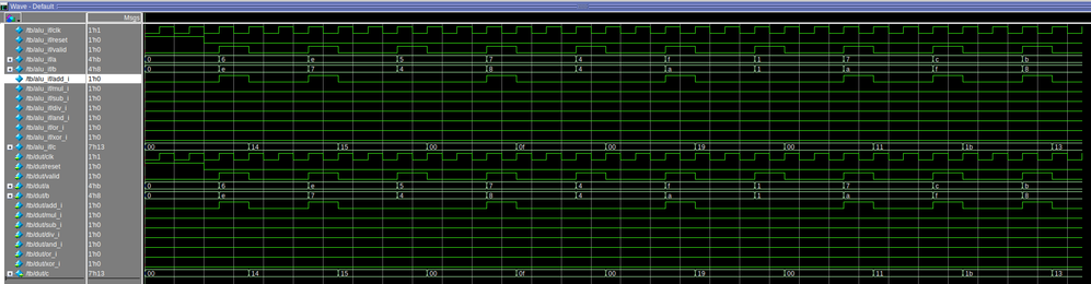

  • Hi,
    In the alu_pkg.sv posted, you may change //vif.add_i <= 1; to vif.add_i <= trans.add_i;       and
    //vif.add_i <= 0; to vif.add_i <= 0; (for clearing purpose this is optional) then you may get below waveform:
    Attached file for your reference.
1 Reply
