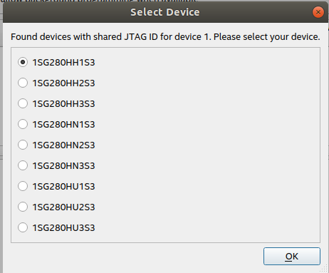

I tried using programmer from Quartus but autodetect shows 10 different devices sharing same JTAG ID.

    Figured. The *.sof file provided by vendor was not compatible with the device. Obtained new file.
