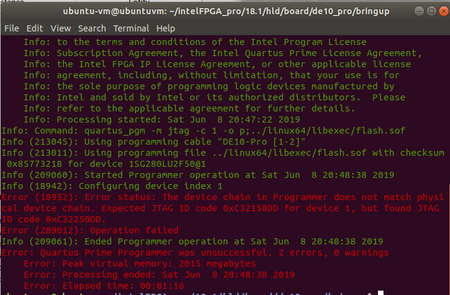

The documentation says to load the *.sof file by calling script in BSP ("./bringing_up fpga"). But I am receiving this error Error (18952): Error status: The device chain in Programmer does not mat...

7 years agoFigured. The *.sof file provided by vendor was not compatible with the device. Obtained new file.
