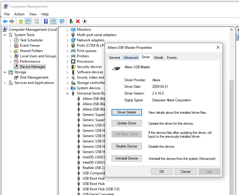

  • ak6dn's avatar
    ak6dn
    I am using Windows 10 Pro 64b 21H2 and have no Altera USB driver issues.
    I have two separate USB pods (a TerAsic Blaster, and a Waveshare USB Blaster from Amazon) and a DE1 board with embedded interface.
    They all work fine, and I see 3x USB interfaces installed and available.
    I use either Quartus 13.0sp1, 16.0, or 21.1 depending on what I am doing.
    Here is what Windows 10 shows about my Altera driver:
