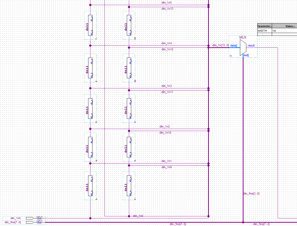

This schematic file is purely combinational with 16 back to back LCELLs and each LCELL's output is given to 16:1 Multiplexer. There are only 2 inputs to this file: a) the signal to which delay is generated and b) the 4 bit select input to the MUX.
As you mentioned the delay is unique to particular device, I would like to tell that this was initially implemented on old generation FPGAs in MAXPLUS. I am porting the design to latest Cyclone 10 family. So, I assume the delay generated on old FPGAs are different compared to Cyclone 10 device, hence the number of LCELLs used must be changed.

I used the report Path command from the input to the schematic block to the output pin of FPGA and could get the timing information on every signal in the schematic. I have attached the report as excel file. But I see that the Multiplexer 54 is not appearing in the timing report. It is the only path for the signal to travel outside the attached schematic. Kindly refer the screenshots of .bdf file (aslo Zoomed ones for better viewing. This platform doesn't allow me to upload a BDF file) and also the remarks mentioned in the excel sheet.
I have also attached the screenshot of the RTL viewer. Does the RTL viewer show the exact implementation as in the BDF file? I do not see a serial connection of LCELLs. Please comment on this too.
