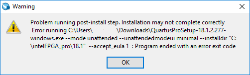

- DZuck17 years ago
- DZuck17 years ago
I tried re-installing it and I got the same Stratix 10 device error message. I also got this error message. - AnandRaj_S_Intel7 years ago
