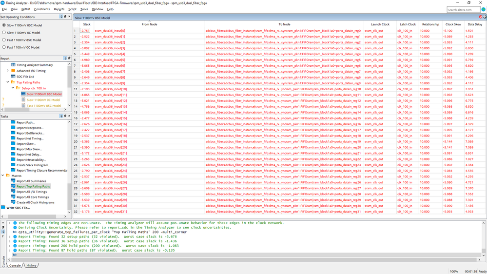

create_clock -name "clk_100_in" -period 10.000ns -waveform { 0.000 5.000 } [get_ports {clk_100_in}] create_generated_clock -name {sram_clk_out} -source [get_ports {clk_100_in}] [get_ports {sram_clk_out}] # SRAM input minimum delay in ns set_input_delay -clock sram_clk_out -min 1.3 [get_ports {sram_data36_inout*}] # SRAM input maximum delay in ns set_input_delay -clock sram_clk_out -max 3 [get_ports {sram_data36_inout*}] # SRAM output minimum delay (=hold time) in ns set_output_delay -clock sram_clk_out -min -0.5 [get_ports {sram_address21_out*}] set_output_delay -clock sram_clk_out -min -0.5 [get_ports {sram_data36_inout*}] # SRAM output maximum delay (=setup time) in ns set_output_delay -clock sram_clk_out -max 1.5 [get_ports {sram_address21_out*}] set_output_delay -clock sram_clk_out -max 1.5 [get_ports {sram_data36_inout*}] set_false_path -to [get_ports sram_clk_out]And my failing paths now look like:

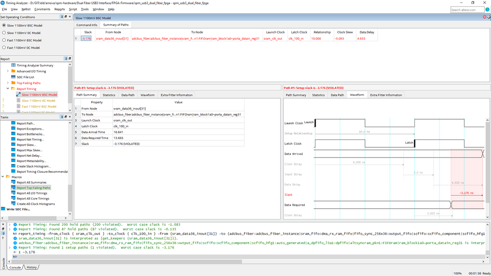

and d31's timing report looks like:
Let me know in case you need additional info. I have a feeling Quartus is having a hard time getting the timing right for sram_data36_inout input-path vs. output-path. What do you think?
