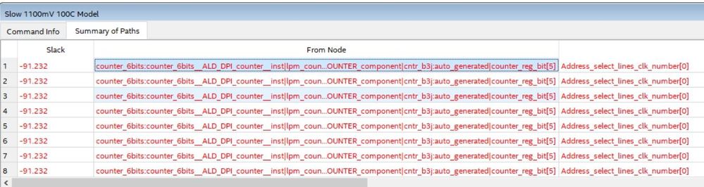

我想要把呼叫出來的IP在 Timing Analyzer 時候將Output 做 set_multicycle_path 約束 我要如何去實現?
set_multicycle_path -from {counter_6bits:counter_6bits__ALD_DPI_counter__inst|lpm_counter:LPM_COUNTER_component|cntr_b3j:auto_generated|counter_reg_bit[5]} -to {Address_select_lines_clk_number[0]} -setup -end 20
我想要一次,所有的BITS要怎麼修改

You may use * to represent one or more characters of the node name(s) you want to assign.

set_multicycle_path -from {counter_6bits:counter_6bits__ALD_DPI_counter__inst|lpm_counter:LPM_COUNTER_component|cntr_b3j:auto_generated|counter_reg_bit[*]} -to {Address_select_lines_clk_number[*]} -setup -end 20
