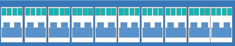

Hello guys,
There is one long regiser array implemented in my project, as following imgae:
Every register is realized to latch its closed ALUT output.

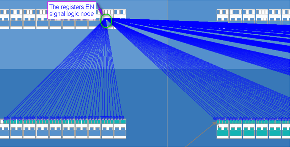

The FF primitive is called to implement above circuit, and the FF's enable port is uesed. The "enable" node is used to enable all resgisers. So this "enable" logic node is high fan-out node, as following image.
So I try to optimize this enable logic node by duplicating it to reduce its high fan-out. However, I will get following error in FIT stage when i apply this optimization. Along the register array, every LAB's first ALM will have this kind of error report.
Error(170208): Cannot place 4 nodes into a single ALM
	Info(170017): Cannot place nodes in a single ALM -- the ALM would be illegal because Illegal ALE template cache hit
	Info(170072): List of 4 nodes in the ALM
		Info(170000): Node "SEP_QuadBLKs_Top_|u_TDC_QuadChs_Core|u3_tdc1ch_cc_dualregdualtdl|u_TDL_CC_DualReg_Topa|u_CarryChainDualRegInC10GX|gen[200].myffa|myff"
			Info(170031): LE location constraint: Region lower-left corner: X91_Y8; Region upper-right corner: X91_Y8; Sublocation: 1 came from User Location Constraints
		Info(170000): Node "SEP_QuadBLKs_Top_|u_TDC_QuadChs_Core|u3_tdc1ch_cc_dualregdualtdl|u_TDL_CC_DualReg_Topa|u_CarryChainDualRegInC10GX|gen[200].myffb|myff"
			Info(170031): LE location constraint: Region lower-left corner: X91_Y8; Region upper-right corner: X91_Y8; Sublocation: 2 came from User Location Constraints
		Info(170000): Node "SEP_QuadBLKs_Top_|u_TDC_QuadChs_Core|u3_tdc1ch_cc_dualregdualtdl|u_TDL_CC_DualReg_Topa|u_CarryChainDualRegInC10GX|gen[201].myffa|myff"
			Info(170031): LE location constraint: Region lower-left corner: X91_Y8; Region upper-right corner: X91_Y8; Sublocation: 4 came from User Location Constraints
		Info(170000): Node "SEP_QuadBLKs_Top_|u_TDC_QuadChs_Core|u3_tdc1ch_cc_dualregdualtdl|u_TDL_CC_DualReg_Topa|u_CarryChainDualRegInC10GX|gen[201].myffb|myff"
			Info(170031): LE location constraint: Region lower-left corner: X91_Y8; Region upper-right corner: X91_Y8; Sublocation: 5 came from User Location Constraints
I just use different EN signals for the odd registers and even registers in that long register array. Why I will meet above error?
  • Hi,
    the problem might be explained by Cyclone 10 GX device handbook, Figure 7. ALM Connection Details for Intel Cyclone 10 GX Devices
    It shows that clock selection (and also clock enable selection, because clock and enable are tied) for adjacent registers isn't independent. There are two muxes for four registers.
    Frank

  • sstrell's avatar
    sstrell
    As it states, you are using some type of physical location constraint that prevents this type of tight fit now that you are duplicating the source register for the enable. What do your constraints and code for this look like?
    • MinzhiWang's avatar
      MinzhiWang
      Hi sstrell,
      The physical location constrains are applied to those registers before this error appear. The FF module is as following code:

      If all 4 registers of single ALM use same enable signal, the project can pass thru full compilation. However, if odd and even use different enable signal the project can't pass thru Fit.

      As above constrains, all single LAB's 40 registers are constrain to corresponding logic nodes. They are grouped to two sets. One is myffa, another one is myffb. If both myffa and myffb use same enable signal, the project can pass thru full compliation. When myffa use ENa and myffb use ENb the project can't pass FIT stage and get the errors presented as the first post.
      BTW, enable is generated as :
      enable <= ena or enb;
      So enable just merger ena and enb. I doubt that the registers inside same LAB can only use same single enable port?
