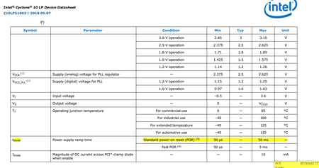

Hi , We use 10CL055YU484C8G. MSEL sets as Standard POR mode, datahseet reqiures ramping time of power supply to be within 50us~50ms. Is this requirement apply for each single power rail's t_ramp or...
- 7 years agoHi, Do you mean that the sum of all power rails' t_ramp should be within 50us-50ms? Yes

7 years agoHi,
Yes
