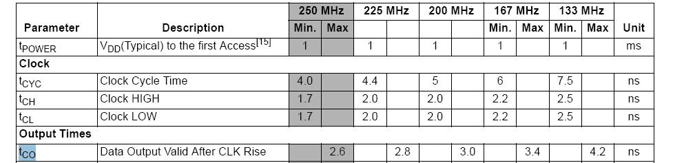

According with the documentation of the module available with SOPC Builder for the SRAM CY7c1380c, I have to set a phase shift to the clock of the SRAM. This phase shift depends of the Tpd(PCB), Tc0(SRAM) and Tsu(FPGA). If I check the datasheet of the memory I can see that is specified a different Tco, depending of the frequency (please, look attached file). I do not know what is the Tpd of my PCB, it is not a Development Kit, is a board designed by a friend. If I am working at 24MHz and with a Cyclone 2 speed grade 8, how must I set this value?. I have already read the documentation but is not clear for me. They talk of differents Tco. ../90sp1/quartus/sopc_builder/documents/ssram_interface... Sugestions? Thank you. DABG.No RepliesBe the first to reply
