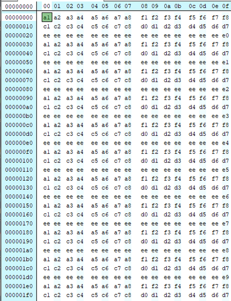

Hi ,
I am currently trying to use PCI-E to transfer data(8byte/once) and write the data to EPCQ through ASMI(page write), but unexpected phenomena appeared in the result, as shown in Fig.
Here is...

5 years agoHi,
Can you try to remove the sector before writing into it? Also, you might need to have some delay after executing write operation.

- open015 years ago
Thanks for your response.
Finally I know where the problem is.....
Because when I use page write, I have to pay attention to the relevant regulations of start address as shown in user guide,
Thanks again for your assistance.
