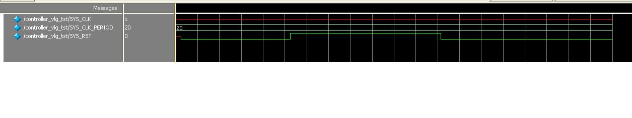

My testbench couldn't generate clock wave.
The code is :
always //@ (SYS_RST, SYS_CLK)
// optional sensitivity list
// @(event1 or event2 or .... eventn)
begin
// code executes for every event on sensitivity list
// insert code here --> begin
if (SYS_RST == 1) begin
SYS_CLK = 0;
end
else begin# (SYS_CLK_PERIOD/2) SYS_CLK = ~ SYS_CLK;
end
@eachvec;
// --> end
end
Following is the snapshot of the waveform and there must be something wrong with always block. Hope someone can point it out.

    Hello.
    In your first example Modelsim executes only first forever line, other lines are not executed (you can verify this by placing breakpoint at second forever operator). This is correct operation as forever operator should be used only once in each initial block. Your second code example demonstrates just that.
    I suggest you to read more about behavioral modeling so you can use this very powerful tool more precisely. See link for example:
    http://www.asic-world.com/verilog/vbehave1.html

    Always block doesn't have sensitivity list, you should write something like
    always @*
    begin
    end
    The main problem with your code though is that you try to change clock signal by itself (I don't know how to better put it).
    Anyway, try this:
    `timescale 1ns / 1ps
    module tb_clk_gen ();
    reg SYS_RST;
    reg SYS_CLK;
    initial
    begin:Reset_Gen
    SYS_RST <= 1'b0;# 50 SYS_RST <= 1'b1;
    end
    initial
    begin:Clock_Gen
    SYS_CLK <= 1'b0;
    wait (~SYS_RST);
    forever# 10 SYS_CLK <= ~SYS_CLK;
    end
    endmodule
