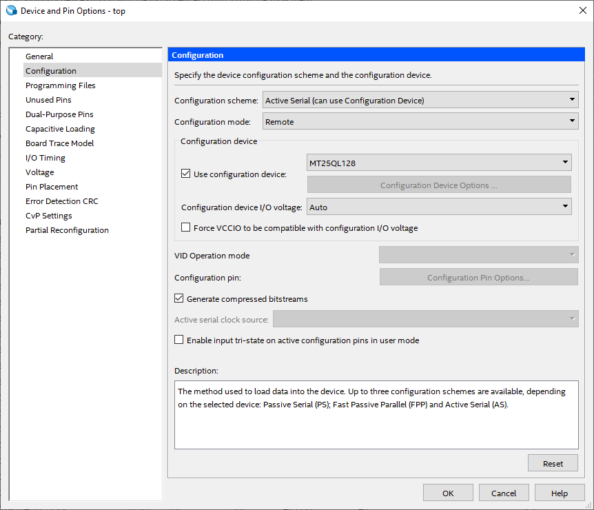

I am doubting about how should I configure the "remote_update.qsys" file if the example project.
As the memory flash in not a ECP device, I believe I should change the value of configuration device:
But in the dropout menu, the device I am using does not exist...
Same happens in the device configuration menu, which one should I select under "use configuration device"?
I have already created .jic files for the memory, and it works, I have created a new device in the "Convert Programming Files..." menu.

Sorry for the dlay in replying... I have finally managed to make it work.
I think I unclicked "Use configuration device" and things related to specific memory use.
