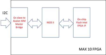

Hi, My device is 10M08DAF256C7G using on a custom board. I am planning to update this FPGA over I2C remotely. This process will be initiated by an micro controller. After going through some documen...

sorry for the late reply. NIOS is not required. You can also design a pure HDL I2C to on-chip flash controller interface. Unfortunately there's no ready-made example available from Intel.
