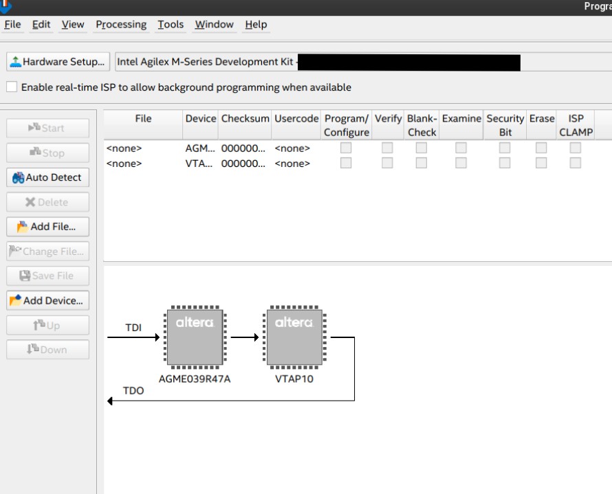

I tried on the same development kit (DK-DEV-AGM039EA) that is available and found the same situation as what your customer reported.
When I use the Quartus Programmer "Auto Detect", it will show AGME039R47A. However, you may ignore this, as this device has the same Device ID as AGMF039R47A. Quartus will auto-choose which device comes first in its list that has the same Device ID detected. Refer here: https://docs.altera.com/r/docs/683748/current/agilextm-7-jtag-boundary-scan-testing-user-guide/device-id

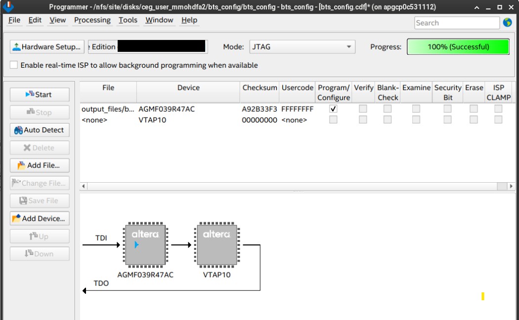

When I try to program the file with the .sof file available in the Installer Package, it programs successfully. So, there is no issue. The development kit should have the correct device OPN, which is AGMF039R47AC.
