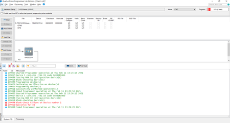

Hey Everyone! First Time Posting Here, So I am sorry if it is on the wrong board. I am using Quartus Prime 2 15.1.0 Build 185 10/21/2012 SJ Lite Edition (No Patches Installed)
Dealing wit...

I would recommend you to disable the "blank" check as the Quartus programming will always performed full erase before programming. This will resolved the issue regarding the 1st programming failure.
scott2j6
5 years agoHi JohnT_Intel,
Thanks for the response.
I have tried everything from leaving blank check unchecked, leaving verify unchecked, ect.
Nothing was successful to get the board to program on the first attempt.
I know an erase is done automatically, but the only two scenarios that I can get a successful programming are:
1) run the programming step 2 times.
2) run the erase operation and then the programming.
Frustrating for sure.
