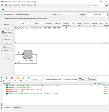

Hello!
I trying to configure 1S280LN3F43 device by sof file (logic + arm) under Quartus Programmer (version Quartus Prime Pro 20.3) and receive next message:
Error(18952): Error status: Synchron...
YuanLi_S_Intel
4 years agoFor error 18952, can you try the following?
- Try with another USB Blaster. USB Blaster II is preferable.
- Change the TCK frequency of USB Blaster II to lower frequency (EG: 6MHz)
- Reinstall the USB Blaster driver and restart your computer.
