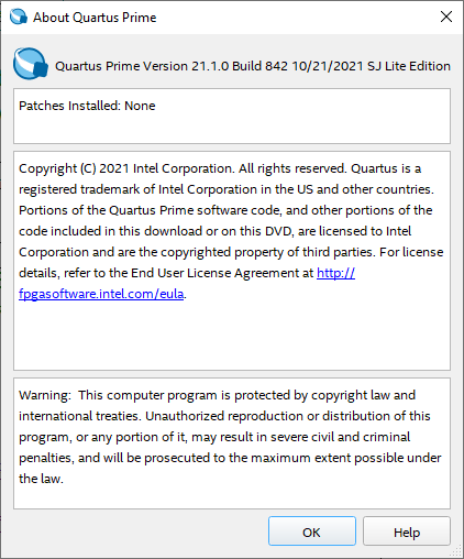

    If I select File | Print, nothing happens. Same if I type ctrl/P. File | Print Setup also does nothing. Same if I click on the little "print" icon at the top of the schematic editor window.
    File | Print Preview brings up the preview screen but the "page setup" icon does nothing. In the print preview screen, the print icon will save a .pdf but no options for format. This is V21.1. Running under Win/10 Pro. Same behavior on my desktop and on my laptop.

      The problem happens on my site as well. The ''Print'' and ''Page Setup'' work just fine in quartus std V21.1 and lite V20.1 but fail working in lite V21.1. Most likely this is a some kind of bug. Anywhere, I'll file a bug ticket to internal on this behalf.
