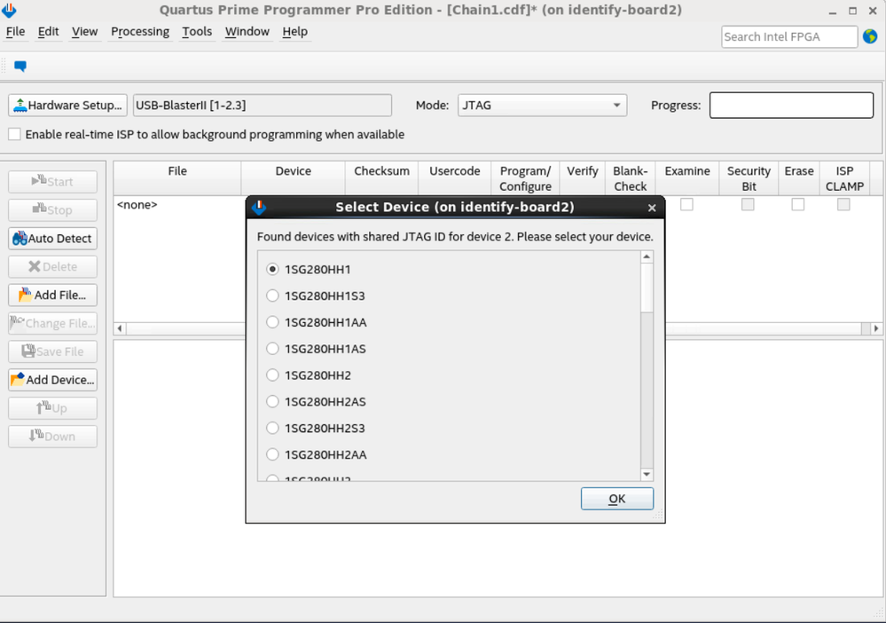

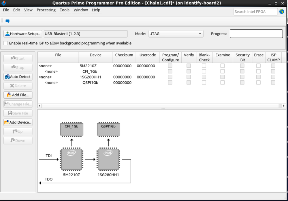

So you assigned stratix file to CPLD EPM2210 or to Stratix? can you post a screenshot of programmer in actual config
and then after pressing auto detect button?
- app_engineer5 years ago
When I bring up the programmer this is what I see:And if I select HH1 device here is the chain:

From your post Device id on board is detected and is different from one on programming file you choose for programming.
I see you are using Linux, this is better choice but has some caveat need be addressed for. Are required library ok? Try launch by shell and look to what happen on terminal.
Chekup also AN807 about board setup, some dip switch on page 7(not MSEL) appear as selected for JTAG CPLD update.
Last question again NO : Stratix 10 is on board and detected by JTAG as from previous answer->
JTAG ID code 0x020A40DD belong to ARRIA II GX EP2AGX125EF29C5 (WRONG)
Expected code was 0x032250DD belonging to on Board Stratix 10 GX (Right one(expected for on board device))
https://bsdl.info/details.htm?sid=c1b9a05b8b8b08b888ca59b002289d77
The error you report appear as programming file not prepared for stratix board.
