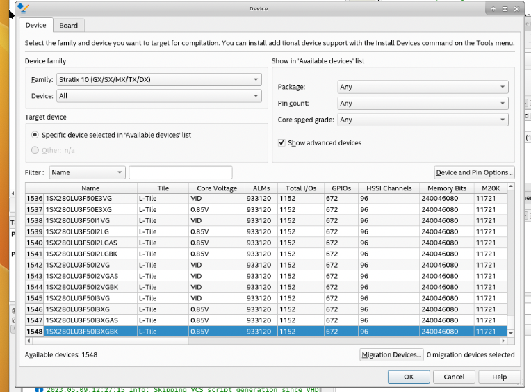

I pick the Stratix 10 on the device section, then put "1SA" at device filter section in Quartus 23.1, there is no device.
Please see the attachment files to see the steps I followed above.
Please see the link below. There is only one device shown in this Intel link. Quartus 23.1 does not give you any option to select this one or any other AX device:
https://www.intel.com/content/www/us/en/products/details/fpga/stratix/10/ax.html

- sstrell
Did you try putting the specific part number in the name filter there?
