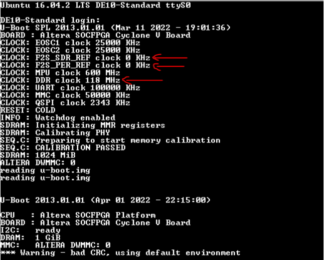

I was not able to find out why the preloader fail due to certain parameters value being used. I suspect is due to the hardware difference of ddr3 being used.
I noticed the quartus version after 18.1 is using the default values as below:
You can try to work with those default values.
These values are found in the hidden parameters in of the HPS IP. You can try right click on the blue gradient in the UI pic above to display the hidden parameters. The parameters in the emif.xml is auto generated based on these settings.
Aik Eu

There is definitively a problem with the preloader generation. I set the clock for the DDR3 from the FPGA at 50Mhz. But the preloader bootloader shows 0.

Thanks. Can you please point out where the hidden fields relevant to the marked items in the boot log are located ?
