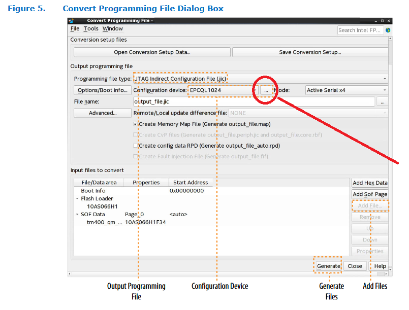

I use quartus prime edition standard 18.1 and the problem is always present
As i showed , on the dialog box "Convert Programming File" , i don't have "..." box (near of Mode text) to add new flash
in cyclone |V and V
- monk31
Finally i found my problem
I migrated my version to 20.1 and it works
to program a generic flash , you must use 18.1.1 but this version don't exist on the Download Center Intel
this is 18.1.0 that you can download

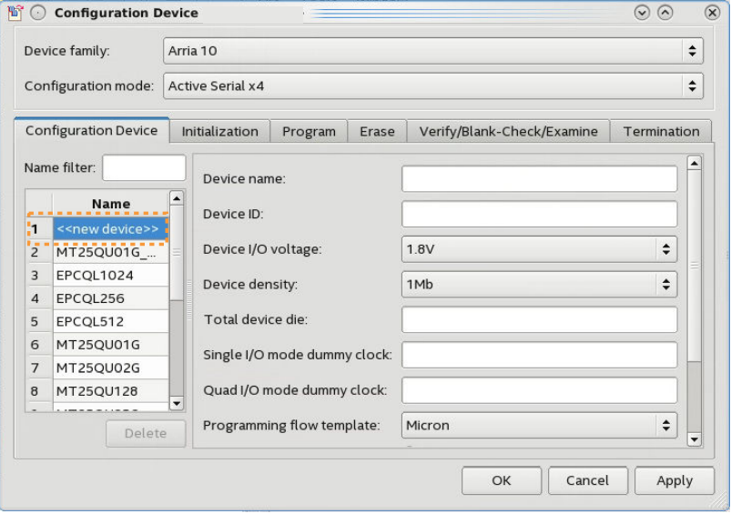

I save a template xml of my flash , and i want to update my database on the other PC.
how can do it this operation ?
- NurAiman_M_Intel
You can create new for Macronix if it is not listed.
Supported Quartus tools:
Kindly follow the userguide:
Aiman
- monk31
yes but with my quartus version (Lite,Standard...), i don't have access to his field
To specify the Configuration device, click the (…) button to select a supported
flash memory device and predefined programming flow

but my question is relative with new flash device
the flash macronix is not in the list when i want to program cyclone |V
and i would like to add to program with my blaster in format JIC
