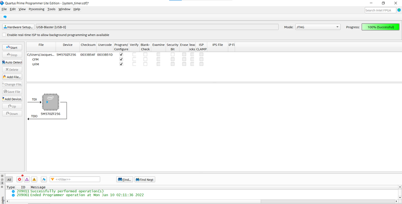

  • duodiscus92's avatar
    duodiscus92
    Sometimes it works. Here is a screenshot when it works
    But generally it don't work. Maybe is it a bad contact at the level of the USB connector on the board ...
