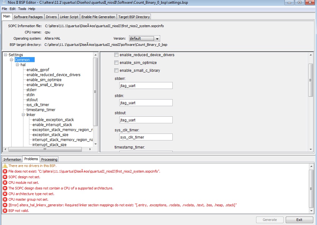

I have build an SOPC system using Quartus 11.1. The system has an on-chip ram. Now, I am using NIOS II - Eclipse platform to build the application. I choose "New NIOS II Application and BSP from template". After adding my SOPC Information file and so far its ok.
Eclipse created two elements at the left side of the panel but no the altera.components.
When i go to the BSP properties, i can see some errors:
-There are no Drivers in this BSP.
-File Does not exist C:..\nombre_sopc_project.sopcinfo.
-SOPC design no set.
-CPU module no set.
-The SOPC design does not contain a CPU of a supported architecture.
-CPU architecture type no set.
-[Error] altera_hal_linkerx_generator: Required linker section mappings do not exist: "[.entry, . exceptions, .rodata, .rwdata, .text, .bss, .heap, .stack]"
-BSP not valid.
Or in the attachment.
I really appreciate your help.
  • Altera_Forum's avatar
    Altera_Forum
    No, i have solved the problem, i only downloaded the altera university program and changed the onchip memory by a sram. But i appreciate the only one comment.

    just wrote the same in another thread... as for my quartus 11 that i use, its understand english symbols only, change project path.
