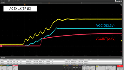

2 years agoPower supplies don't rise monotonically
In ACEX 1K and Cyclone, the power supply don't rise not monotonically. The waveforms is shown below. Is the 3.3V in Cyclone "monotonically"? Also, the 2.5V in ACEX 1K has a slope that is always...
Inoue_PTX
2 years agoHello Farabi
Thank you for replying.
If this non-monotonicity, can intel guarantee that the FPGA work correctly?
If not, what kind of defects can be expected? (ex; I/O pins output incorrectly, possible corruption ect)
