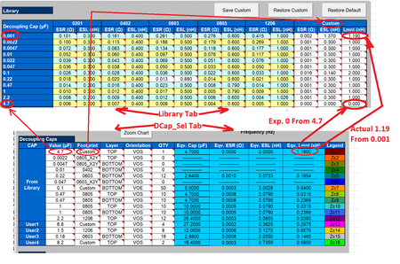

Hello FPGA Forum, having an issue with the fpga pdn tool (device agnostic from website):
The value of “Custom-Lmnt” in the Decap Selection Tab is not being set to the capacitors “Custom-Lmnt” fro...

Hi Farabi,
The PDN Rev is 1.1, see screen shot below. Program is classified, can't share device.
-John

4 years agoHi Farabi,
Unfortunately, the best I can do at this time is to let you know I've downloaded the 28nm_pdn_hid_04_27 PDN tool and that's working.
-John
