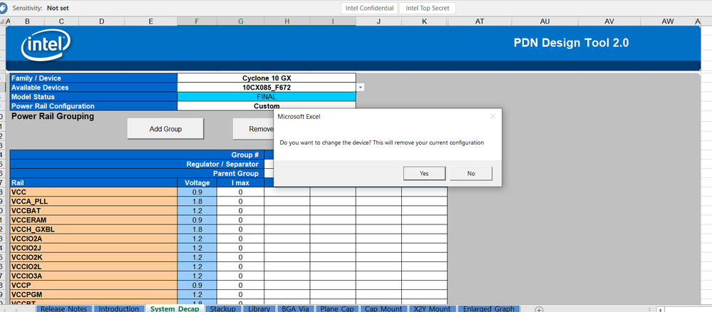

PDN tool 2.0 for cyclone 10 GX
When I use PDN tool 2.0 for cyclone 10 GX, there is no available devices for cyclone 10. All of the devices listed are from Stratix 10.
I guess it's because the tool is not automatically updated after I choose Cyclone 10 family.
Is there a solution to it?

    • madmarx1220's avatar
      madmarx1220
      Thank you for your response.
      I used the arrow down button. However, all of the devices appear are from Stratix, instead of Cyclone.
      I'm using 10CX220YF780E5G device, but no such device listed in the list. Not even F780 devices listed.
      But in the Family/Device category, I do choose Cyclone 10 GX.
      Thank you.
      • AminT_Intel's avatar
        AminT_Intel
        Thank you for pointed that out. I found that that you need to enable content change from Excel. My content of PDN excel is only changed when I enabled the change. There is a prompt at the top of excel to enable change of the Excel when you just opened the document. You should be able to see the prompt. If not, maybe delete this Excel and re-download them and see if the prompt to enable change. If you still can't find the prompt maybe search online on how to do that on your version of Excel. You should see this message every time you change model in your Excel.
