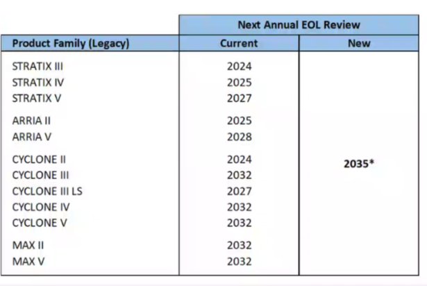

    9Not sure if PDN2041 is still valid regarding MAX II series CPLD. EOL of 2035 has been announced in later Altera statements. Below quoted discussion refers also to MAX II
    Max V Lifecycle 2035? | Altera Community - 251208
    I'd appreciate a clarification.
    P.S.
    Below table is shown in the link. Can it be that MAX II has been included erroneously?

      Yes, base on latest official announcement, all MAXII and MAXV will be continue to be available until 2035. Unless the specific OPN is mention in PDN(Product Discontinuance Notice).

    Yes, pls refer to PDN. I am sorry, No drop in replacement.
