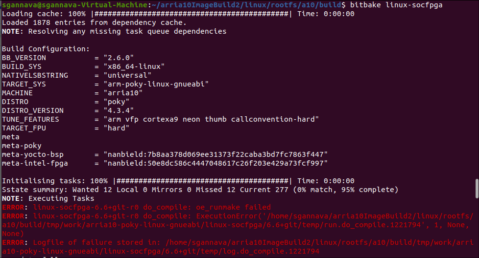

    Hi Aik,
    I am following the same documentation to build my custom Linux image for Arria10 SoC development kit. While building Yocto Rootfs, I am facing oe_runmake error. I have attached the log as well.
    This is happening in the build process while compiling linux-socfpga-6.6+git package.
    I tried below steps as well
    step-1: bitbake -c cleanall linux-socfpga
    step-2: bitbake linux-socfpga
    But at step-2, again same issues.
    Any help would be appreciated.
    Sai

    Hi Aik,
    I am able to build the image successfully by removing the linux-socfpga_6.6bb (which is causing the error) blindly following the steps mentioned in the documentation. But I have below questions
