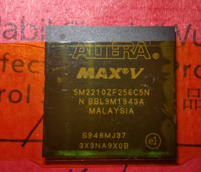

NetApp /Jabil Wuxi _ Failure analysis request on 2pcs customer RMA sample 5M2210ZF256C5N
Hi Intel RMA /FA team,
Jabil WuXI received 2pcs customer field returned component ,we have to request FA to manufacturer base on customer requirement.
Pls help co-ordinate this FA request and release RMA# to us for sample return ASAP. Thanks!
JPN: 300-J9127R6
MPN: 5M2210ZF256C5N
Supplier: Intel
Qty:2pcs
PO#:9085311990
GRN#1088546851
Problem Description: NO BOOT
Debug analysis finding: ①Sample1(SN#032017002547) P1V8_EBOD to GND short, (U9 K6 PIN)
② Sample2 (SN#)032017002536 P1V8_EBOD&P3V3_EBOD to GND short(U9 K6 T14 PIN)
Detailed information refer to attachments.
