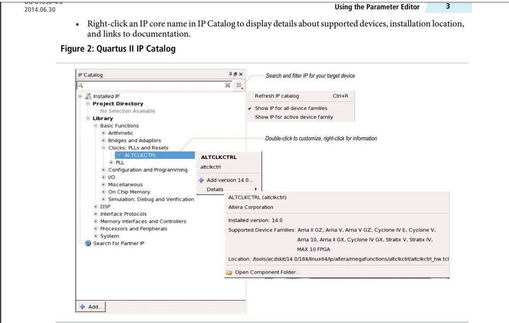

  • Vicky1's avatar
    Vicky1
    You can check by doing Right-click an IP core name in IP Catalog as shown below,
    I hope it may helps to you.
    Best Regards
    Vikas Jathar
  • Vicky1's avatar
    Vicky1
    You can check 'open component folder' by doing Right-click an IP core name in IP Catalog as shown below,
    Best Regards
    Vikas Jathar
