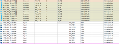

Hello Guys, We are using Max 10 device, the part number is "10M25DAF484C7G". Our Quartus version is 23.1std.0991 standard edition. There are several ADC input buses which are connected to Max 10. H...
- 2 years ago
You have signals named incorrectly (OUT vs. Out). You should not enter signal names manually in the Pin Planner. They will appear there after Analysis & Elaboration so you can select location and other I/O-related assignments.

- MinzhiWang2 years ago
Hi Aqid,
No, it's enough for us. We have resolve this issue now.
