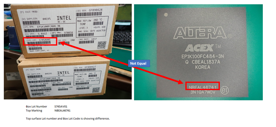

Marking and Lot number: EP1K100FC484-3N
Regarding EP1K100FC484-3N, outside BOX lot number and Top markings are different.
Is this just difference for batch and serial number?
Box showing lot number: S745AV01
Marking shows Lot Number: NBEAL45741

    Hi Tomo Nakama,
    Thank you for the picture provided.
    This is normal due to the integration between Intel and Altera. The top marking lot number is Altera lot number while the lot number on the box is Intel FPO number.

    Hi Tomo Nakama,
    Could you confirm on the number writing outside the box is a lot number? Maybe you can share to me the picture?
    Aqid Ayman

      Hi Aqid,
      Here is picture of Box and top surface marking.
      I was wondering why the Box LOT code is different from Top surface marking.
