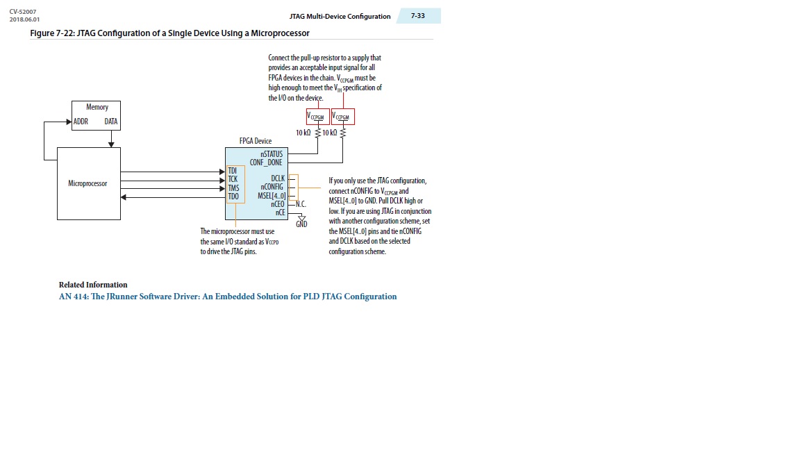

    Here is extract from Cyclone V Device Handbook, page 7-33.
    Schematic of pin-connection while programming from external microprocessor over JTAG.
    ... and nothing else !!!
    Is programming-related information protected ?
