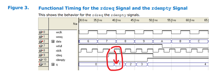

Latency of rdreq to q[] in DCFIFO
In the FIFO User guide I see the following in Table 7: Output latency of rdreq to q[] : 1 rdlck. At the same time, on Figure 3 ( Functional Timing for the rdreq Signal and the rdempty Signal ),...
  • SyafieqS's avatar
    4 years ago
    Andrey,
    Thanks for you input. This probably related to documentation spec bug which I will file for fix. Seem there is discrepancy between spec and diagram 3.
