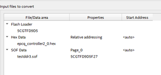

We are trying JIC file programming in our design. Initial part we have tried JIC file programming with OCM as exception vector of NIOS II Processor.
We successfully checked that in board.
Now we are trying JIC file programming with DDR3 as exception vector of NIOS II processor.
In the DDR3 JIC setup, FPGA boot up is working properly and firmware is not working properly.
The following settings are used for JIC File programming using DDR3:
please give guidance to setup the jic file programming with ddr3 memory.
