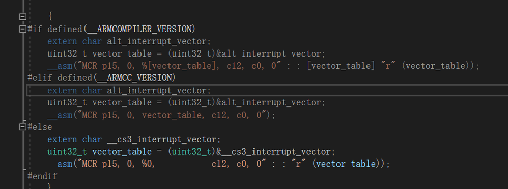

I include the <alt_interrupt.h> in order to use the interrupt on HPS form fpga,
I got the following error
which I believe from this block in <alt_interrupt.h>:
Could you please tell me how to solve this problem?
reguards

  • CAlex's avatar
    CAlex
    Ok,It's on the first picture if wouldn't mind click it.
    It says: on src/hwmgr/alt_interrupt.c(951) error: undefined reference to "__cs3_interrupt_vector"
  • aikeu's avatar
    aikeu
    Hi CAlex,
    I am not able to see the error from the pictures(blur) that you have attached.
    Can show me the error again?
    Aik Eu
