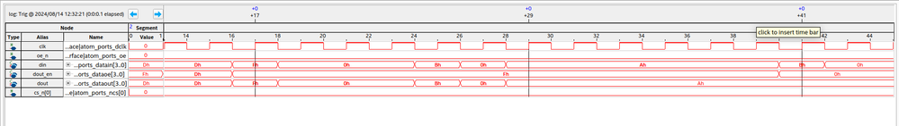

You can see this below which shows the reading of val3. The first mark shows the first address nibble (in dout). The second mark shows how 0xA is output in the first dummy cycle (i.e. mode) (in dout). The third mark is the data being returned (in din).
Is it actually possible to use the Generic Serial Flash IP when a mode is included in the operation? To make the IP work I had to configure 6 dummy cycles (+2 for the mode and +4 for the dummy cycles). Is there a way to fix the value output during dummy cycles?
