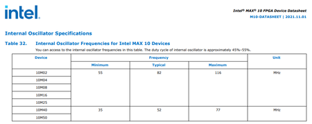

Hi Would like to check the Minimum and Maximum frequency specification on MAX10 internal oscillator.
Q1 : Is the internal oscillator frequency selectable from range 55~116Mhz.
Q2 : If Q1 ...

A1: No, the internal oscillator frequency not selectable. You can just select the simulation frequency from internal oscillator IP.
A2: Internal oscillator frequency depends on FPGA's physical conditions. It may vary and not accurate. But you can use typical frequency values for internal oscillator's frequency.
A3: I don't know it is suitable for stepper motors but I suggest you to use an external oscillator or PLL for consistent and accurate frequencies for sensitive operations.
