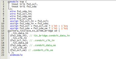

Hi, I'm trying to use Intel FPGA I2C Agent Avalon-MM Host Bridge Core to read FPGA's memory content through I2C. But I'm stuck in the first step. I cannot make the IP work. I included .qsys and .q...
