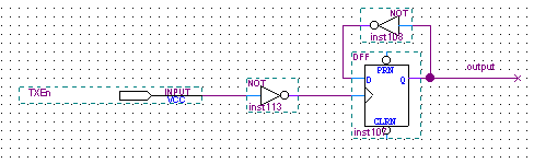

input pin to clock dff
- it is possible that quartus connect external pin to clock via not (inst13)
- Thank you
- Regaerd.

Did you find the solution? if you still having the same issue, can you share your design?

which is the purpose of the not (inst4)? Can you try your design without the not?
If this didn't work, can you provide me your design to work on the debug?

when clock are dircet input pin i have this message :
Warning: Can't achieve minimum setup and hold requirement RXFn along 24 path(s). See Report window for details
also i do see in attachment
I have another message
Warning: Can't achieve minimum setup and hold requirement clk32 along 696 path(s). See Report window for details
My clock provide fromp 3,3v 33Mhz oscillator connected at input clock (ep3c5)
Regard
