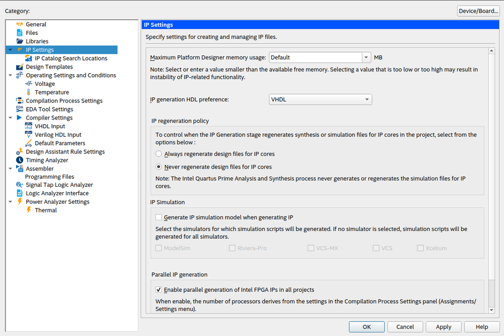

  • Hi @sgannava ,
    I just ran into these settings on Quartus Pro, from Assignments -> Settings -> IP Settings. By default it's chosen to never re-generate the IP files, maybe if you change that in your project, it can help you.

  • sgannava's avatar
    sgannava
    I tried that as well. But it is not working. It is still showing the same warning
