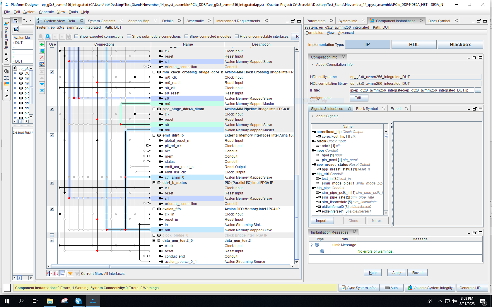

I have a modified version of PCIe DMA transfer example design mentioned in the Chapter 7 of attached user manual (I added a custom generated data generator IP and an Avalon FIFO Memory Intel IP to the existing DMA transfer example design {Platform designer screenshot is attached as DMA_modified_part1.PNG and DMA_modified_part2.PNG}) .
My aim is to continuously generate data (bit stream) in the FPGA using a custom built data generator IP and pass it through a FIFO to the DDR4 memory, and then do a DMA transfer though the PCIe to the host computer. Basically a continuous DMA read (just read) from the data saved in the FPGA DDR4 memory.
