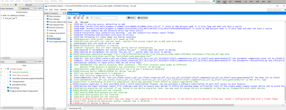

How to modify Archer_City_PLD_source_code from 10M05 to 10M02
As title, I want to modify Archer_City_PLD_source_code from 10M50 to 10M02.
Is this feasible?
How to execute?
Are there any restrictions on the technical board's code?

  • Hi Terry,
    Kindly try go to device and pin option, change the config mode to single image.
    I believe your migrate device doesn't support multiple image.
    Do let me know if any issue persist.
    Pavee

      Hi Paveetirra_Srie,
      Sorry for reply lately. I try to change the config mode to single image.
      It's okay.
