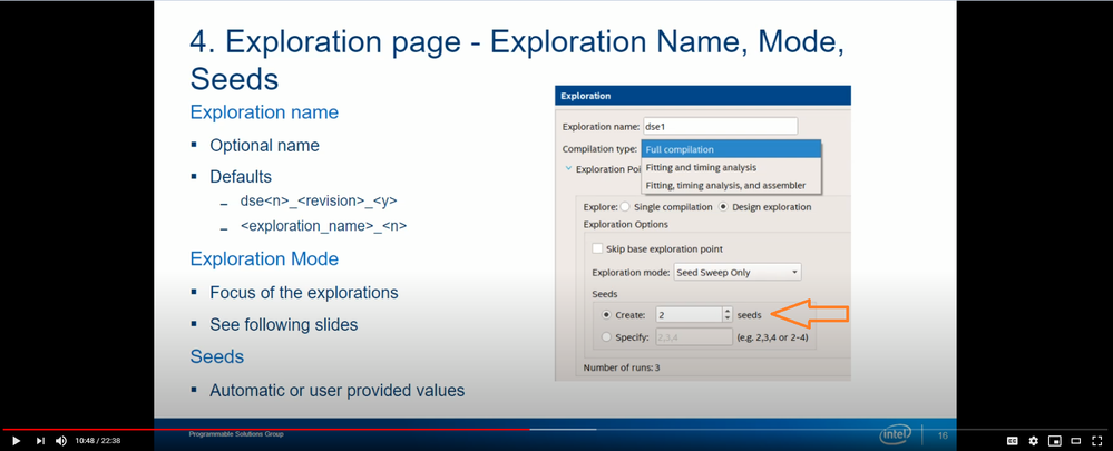

    thank you for your response. Can you please how to perform a seed sweep? I guess this is an initial seed for the PnR that Quartus performs, right?
    Thank you in advance for your response.

  • KhaiChein_Y_Intel's avatar
    KhaiChein_Y_Intel
    Yes. It is the frequency that the design can reach at this compilation. You may see a different value if you perform a seed sweep or change the compiler settings.
    The value stated in Fmax summary reports potential fmax for every clock in the design, regardless of the user-specified clock periods. The "Note" column reports which analyses restricted fmax.
