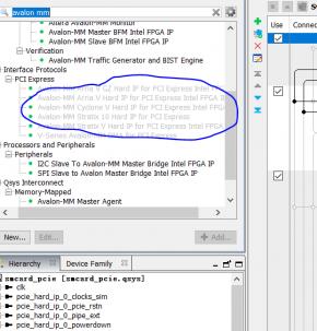

    If that device does not support hard ip why does it still in the list?
  • Altera_Forum's avatar
    Altera_Forum
    EP4CGX75CF23 is Cyclone V series, but why I can't see the item become enable?
    Altera_Forum
    System Settings or Device tab (depending on which edition of the tool you're using)
    Altera_Forum
    How can the QSys knows which FPGA I have used in the design? I used EP4CGX75CF23 in my PCIe card, why those items still in disable state?
    Altera_Forum
    Yes. You can also click the little gear above to make them available, but that means you'll have to move the generated files to a project targeting the supported device instead of using it for this project.
    Altera_Forum
    I used one of the FPGA listed in the table to design my own PCIe card as the target device then that option will automatically activated?
    Altera_Forum
    Your target device has to be one of the device families listed for the IP.
